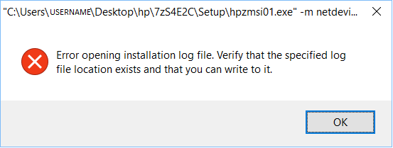

The HP Solution Center, which I always used for scanning, however terminated with the notice telling me the printer was not installed correctly. I downloaded 'HP Photosmart and Officejet Full Feature Software and Drivers' from the HP website (AIO_CDB_Net_Full_Win_WW_140_408-5.exe) . But it doesn't install.
I tried removing all HP software using Add & Remove programs in Windows 10, but none of the uninstallers worked.
I then used Revu uninstaller to force the uninstallation, remove registry entries and related files from my hard disk.
Afterwards I tried again to install the above printer software but it still terminates with the same logging error:
Further details:
I also tried to run the setup from another location than the default location the temporary files are extracted to. The result stays the same. I also tried installing after a clean boot with all non-Microsoft services disabled, but to no afail.
