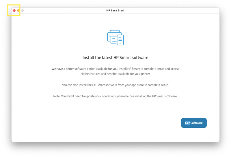

As soon as HP Easy start prompts to install HP Smart, close HP Easy Start by pressing the Red X and press the Skip to Software Download button:
Figure 2:
Figure 3:
then follow the steps on screen to complete the installation, be sure to switch to an HP Driver during the setup, if any such option is shown:
Figure 4: Switch driver option may appear
Now try printing and check for any difference.
