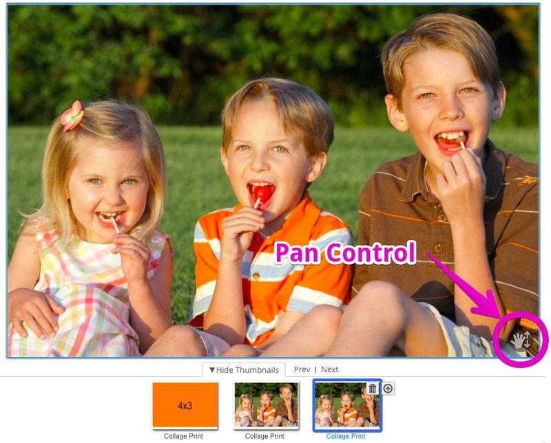

If you'd like to control what gets cropped (perhaps an important part of the image is near the top edge), I recommend the Collage Prints project instead:
  1. Choose a Design Your Own collage print and add your photo to HP Photo Creations.
  2. Drag the photo toward the edge of the layout until you see the green border appear, then release. The photo will expand to fill the page.
  3. Drag the pan control up or down to reveal the part you want.
Here's a step-by-step tutorial on adding photos to HP Photo Creations:

Drag the pan control to position the photo.Drag the pan control to position the photo.
