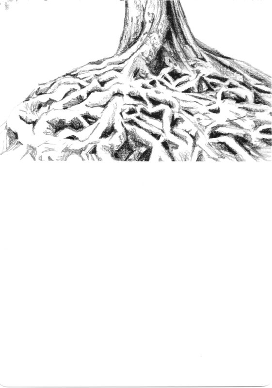

Printing 5x7 prints after changing ink and installing new software from HP website.
Printed the first one fine,  every one after that has lined up wrong to print the image correctly, and no two are alike.
Only the bottom half of the image prints on the top half of the page. 4x6 prints are printing fine.
I'm printing through a USB connection from a dell desktop computer.
I have uninstalled and reinstalled the software/drivers, this did not fix the problem.tree.jpgscan0001.jpg
The top image is the whole picture, the bottom image is what prints.

Thank you for your quick reply to my issue. Your information was easy to follow and solved my problem.
