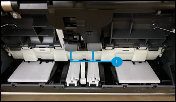

Clean the paper feed rollers
Gather the following items:
A lint-free cloth or swab
Distilled, filtered, or bottled water (tap water might damage the printer)
Turn off the printer.
Unplug the power cord and disconnect any other cable.
Lightly dampen a lint-free cloth with distilled or filtered water, and then squeeze any excess liquid from the cloth.
Remove the input tray.
Pull out the main tray, and then gently tilt the printer from the front (about 60°) to access the printer base.
Clean the rollers by wiping them with the cloth. Be sure to clean the entire surface of the rollers.
Cleaning the paper feed rollers
Allow the rollers to dry completely (approximately 10 minutes).
