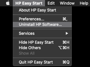

It really looks like those who are experiencing this issue are running older software signed with a certificate that expired today.
Please update your software using HP Easy Start as mentioned above.
1. Download HP Easy Start
2. Follow the prompts for setting up your printer.  When you get to the software download it will show whether the software needs updated or not.  If it does the box next to Printer Essentials will be checked by default and you just need to select the Install button.
The following should not be necessary but if you want to be extra diligent and guarantee a clean new install.
2. Open HP Easy Start and Select the HP Easy Start Menu in the macOS menu bar.  In this menu select Uninstall HP Software.
3.Select Continue to start the Uninstall process
