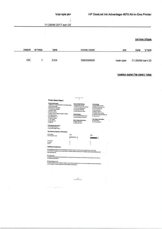

do you have a picture of such confirmation in order to see how it looks like?  and are all the hp
printers print the same format shape of the confirmation?
suncerly
Giries
Hi,
I do not have such a sample available, but will make one and share with you a sample from the 5275 printer as soon as access the printer on Monday, the format should be quite similar for all current HP printers..

Hi @Giries
Here is a sample from the 4675 model, teh 5275 report is identical to the sample shown below:
