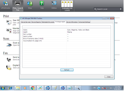

After I upgread the  frimwear for  printer officejet 7500A  I do full reset
after that   the printer stopped at welcom screen   (install printhead) I use hp print assistent
to find out the problem  mseg say (The printhead identified  is missing, not detected, or incorrectly installed in the printer.)
I clean the head printer and remove it and istall again but it not working .
I use refill ink cartridge with auto reset chip (arc)
I test the headprinter  at another printer ....its working normaly .
could you help how can i resolve this problem.
thank you
