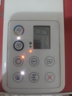

My printer is the HP Deskjet Ink Advantage 3777. So, the problem is, when I turn on my printer and leave it for a while, it flashes the E warning, and the resume button and the wireless button are blinking. When I try to press any button, nothing happens.
When I unplug and plug the printer again, the power button goes off, and the only buttons flashing (not blinking) are the Wi-Fi- Direct, Web services, and the Start Copy Buttons. Nothing happens no matter what button I press, even the power button. It's been going on for some time now (like two months) and the printer itself is fine.  I know there is no disruption of power because some of the buttons are still flashing.
It just happened out of the blue.
Can someone please tell me how to fix it or what could the problem be?

Hello, thank you so much for replying to my post. To provide better context, about the buttons flashing. Here is a picture of the first scenario and second scenario: The first picture happens when I first start my printer. It is not responsive, any button I press does nothing.  After restarting (unplugging the power cord), the second picture happens.
I hope this provides you with enough context about the malfunction of my printer. I would greatly appreciate your response. first scenario (before restart)first scenario (before restart)second scenario (after restart)second scenario (after restart)

The light pattern on your second image appears to be the ink alert and the Web services light.
    If both the Web Services light and the HP Instant Ink icon blink and the HP Instant Ink Service has been recently cancelled, press the Information button twice to resume printing.
Unless something else is going on, perhaps the printer is tripping over a recently cancelled Instant Ink subscription.
If you did have -- and have since cancelled -- an Instant Ink subscription, it does take a while for the final close out to complete.
If you continue to have issues,
Contact HP Instant Ink Support during business days and hours available in your region.
Ask for help ...
