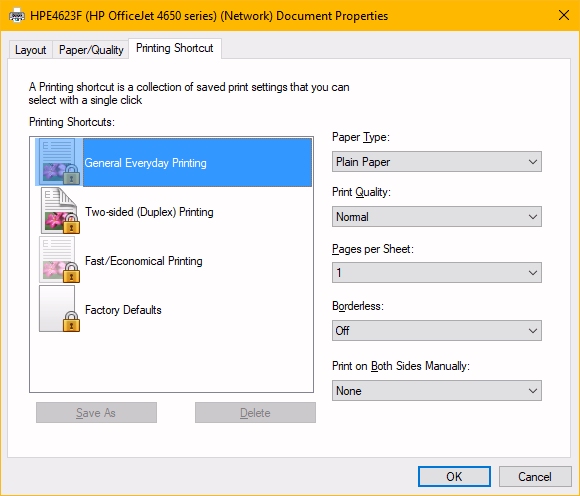

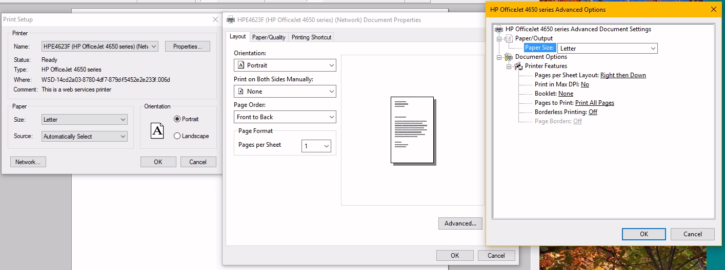

07-16-2017 07:35 PM
Thanks for your response. The steps you recommend are familiar. However, trying again never hurts.
I have carefully followed all the instructions. I also did an extra shutdown and reboot just before your Step 2. But I still have the same problem!
I attach screenshots of the Properties available for the printer in case they help you see what the problem is. (You can see that the Printing Shortcut tab shows images with color; but the printout is still only in greyscale.)
Any other suggestions?
