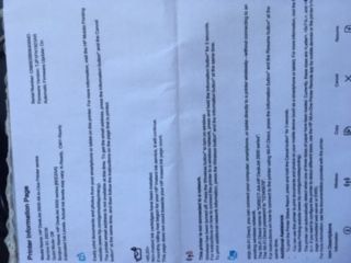

Thanks but I tried all of the above. The prints works and prints fine but the information light never stops bling. If I press on the button, it prints the same message over and over again
@Pippincat1
What's the message that gets printed? Can you post a picture of the Information Page?
Thanks!
Asmita
I am an HP Employee

Hi @Pippincat1
Thanks for confirming. The printer is trying to connect through the Wi-Fi Direct.
To turn Wi-Fi Direct off -
On the printer control panel, press and hold the Wireless button and the Resume button together for three seconds. When Wi-Fi Direct is turned off, the Wi-Fi Direct icon on the display is off.
