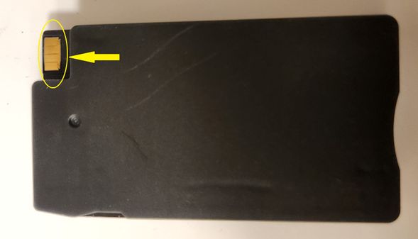

  2. Turn on the printer and open the front panel as if you were changing the cartridges.  Remove the cartridges.  As you remove them turn them so you can see the four gold pads in the upper left rear of the cartridge as it is removed from the printer.  Wipe the gold pads with a damp tisssue then set the cartridge aside.   Repeat for the other cartridges.                                                                  Cartridge.jpg

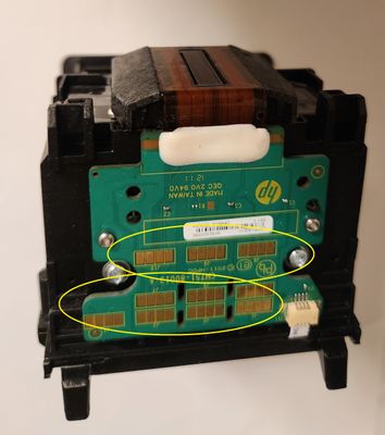

  6. Turn the printhead assembly over so the nozzles are once again pointing downward and then look at the back side.                                                                Bob_Headrick_2-1707376146476.jpeg
  7. There are a series of gold rectangular contacts.  Gently wipe then with a damp q-tip.  Make sure to remove any dust (or pet hair) that may be present on the electrical contacts. Put a few layers of paper towels on the work surface and place the printhead assembly with the electrical contacts you just cleaned facing downward on the paper towels. Next, turn the printhead assembly so you can look in the area where the cartridges would be installed.Bob_Headrick_3-1707376146669.jpeg
