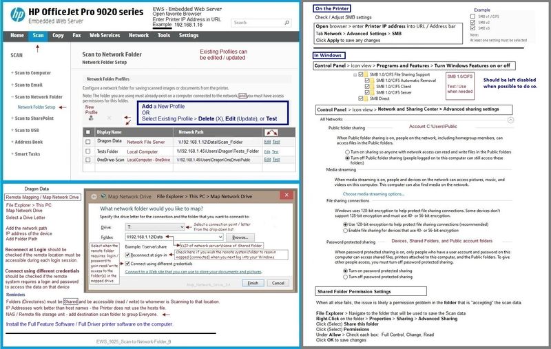

This printer supports "Scan to Network Folder"
At least part of that setup can be completed using the Embedded Web Server (EWS).
EWS is available from within HP Smart.
EWS – Browser
Open your favorite browser > type / enter Printer IP address into URL / Address bar
Tab Scan > Scan to Network Folder
EWS - HP Smart for Mobile - iOS
Reminder: The EWS Tray and Paper settings must be updated before you open the object to be printed.
Open HP Smart (for mobile)
Open Settings
Open Add / Set Up a Printer
For example - open Scroll down, Click, Tray and Paper
EWS - HP Smart – Windows
Start HP Smart Application
Printer Settings
In section Settings > Advanced
Example
EWS_9025_Scan-to-Network-Folder_9EWS_9025_Scan-to-Network-Folder_9
Open Settings
Printer Settings
Example

Where do i find
First, if you have not done so,
Install the Full Feature Software / Full Driver for the printer
Next,
Enable the ScanToPCApplication on the computer"
For the 9025e?
@johncan01
@johncan01 wrote:
Where do i find
1.  Install the Full Feature Software / Full Driver for the printer
Next,
2.  Enable the ScanToPCApplication on the computer"
For the 9025e?
1.  Answered in the solution.
Start at Section Method - Use the Easy Start Wrapper to Install the Full Feature / Full Driver Software
Use the HP Easy Start Software wrapper to install the full driver printer software.
2.  After the printer software is installed,
Check / Configure Scan to Computer
After the installation of the printer software is complete,
Open the Printer Assistant (shortcut named for the printer on your Desktop)
Click Scan > Manage Scan to Computer
If not done, Click to Enable the feature
Scan from the printer to the computer:
To use, select the exact computer name listed - no extra letters or words in the name
