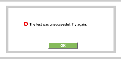

I 've set up my printer to scan to a network folder on my Macbook Air running MacOS 10.14.3.
After I've configured the set up using the printer's embedded server webpage I test it and get the very error message " The test was unsuccessful. Try again" which is a contender for the most unhelpful error message!

You need to go get the latest firmware for the M477.  It has a fix for scn to network folder issues in High Sierra and Mojave.

Thanks for the tip about the new firmware for the M477 IronBadger.
I have updated the firmware with the datecode 20190113 but am still having the original problem.
What do you suggest as next steps?
thanks
Fred
Ok that is a different issue.  The firmware fixes an issue where the test would work but anything scanned over 72 dpi would fail.  That looks like a more direct communications issue.  It's good you have it now but would not resolve this.

Thanks IronBadger. Your updated PDF was helpful and I'm going to keep for future reference.
Part of the problem I had was with the pointer to the shared folder where scans are sent. Specifically the folder was nested several levels within my documents folder. When I relocated it to the highest level I was able to scan to a folder.
The only other problem I have is that the IP for my Mac changes every time I reboot it, which causes me to have to update my Mac's IP address using the Embedded Web Server. Is there any easy way around this?
