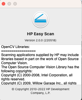

As the countless people on this thread have already stated....there IS an Easy Scan 2.0. It's not available in the app store, you have to find it at hp.com
Here's proof....yet again.

Read the previous posts. It is not signed so Apple cannot verify it. You have to right-click it and then select Open. It will run.
