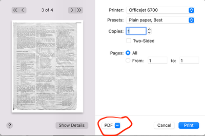

The work around is, instead of saving a pdf, is to print to a pdf file.  The steps are:
  1. Click on the HP Easy Scan File menu and select Print OR type ⌘P
  2. There's a dropdown menu in the middle of the bottom of the print window that says PDF. Click the down arrow and select Save as PDFScreen Shot 2024-06-11 at 5.43.02 PM.png
  3. Type in a filename and click Save.
Hope this helps anyone in need.
