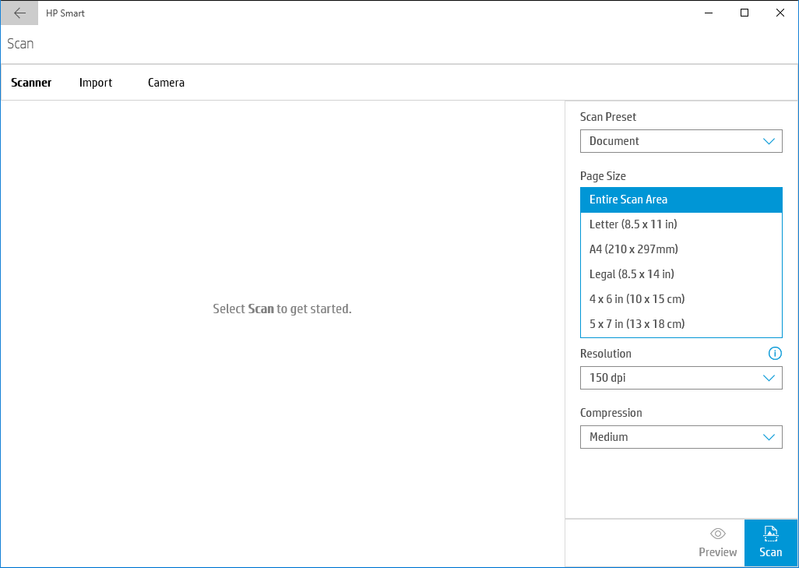

Hello, neither HP Smart nor HP Scan and Capture gives the option for 11x17. I select the source (scanner glass), then go to select page size, and there are only  is no option for tabloid or 11x17. See the first image below for a list of available sizes. I also tried using the "Entire Scan Area" option, and it can scan the entire document, but I cannot then crop the image to 11x17 (see the second image below, note that I had to block out the image). And if I try to use the "Custom" option, it lets me drag the corners, but I cannot enter the sizes so I cannot make it exact.

@ramahoney
Using the HP Printer Assistant, Click on Scan, Then drop the box for Page Size and select custom.
In the Custom Scan Size you can enter the Width and Height.
If the information I've provided was helpful, give us some reinforcement by clicking the "Solution Accepted" on this Post and it will also help other community members with similar issue.
KrazyToad
I Am An HP Employee
This works, thank you! Additionally I went into the post-scan settings and here I can adjust the settings that caused the problems in the original post.
