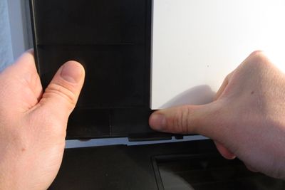

Hi,
HP's manual is misleading.
What i found to be the best way was disconnecting one hinge at a time, like this:
Use one hand to hold and support the lid in the lower corner of the given hinge. So that once the hinge comes off, nothing breaks. Dont worry the other hinge still allows for quiet a bit of movement.
With the other hand pres with your thumb, just above the hinge, in an outward motion away from the printer body.
The hinge should easily disconnect. Check out the picture of the hinge hook on the lid. That will give you an idea of how to apply the pressure.
Hope that helps 🙂
