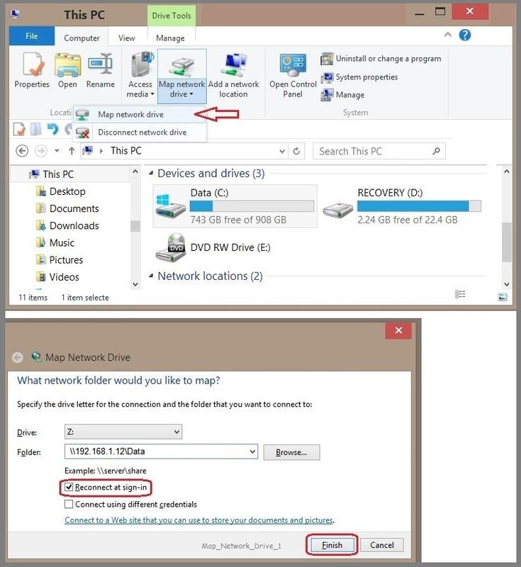

Mount point on Windows computer
Map_Network_Drive_1
Interestingly, although the NAS account folder (on the NAS) is owned by the local NAS user "Dragon", the password to access that account from the Windows side might be that of the Microsoft account on the computer on which the NAS is mapped. It just depends on how the accounts are managed. Ignore this if it seems out-of-place.
