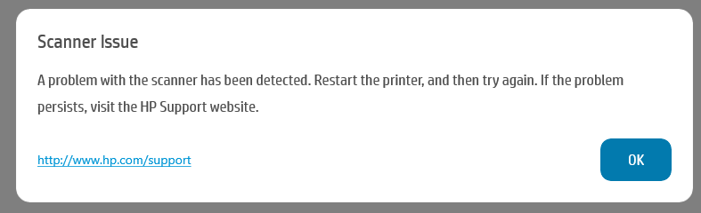

Yesterday a friend told me that there's a combination of buttons to press on the controld panel of the MFP itself which resets it to default state or something like that. Using it, I was able to scan another 10 pages, each time preinting a configuration report in between, or a test page, or an error report. But now it is stuck again, and no matter how many times I press the combination on the control panel, the scanner still gives me an error at the end of the scanning prodess.Screenshot_5.png
I tried to scan with Photoshop. It gives a more detailed account of scanning stages.
First it said Preparing for scanning, and that went fine, But then...
By the way, I tried all of this on another computer, and the result is exactly the same.
