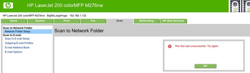

@sandytechy20
Removing and re-adding the scan to network folder still results in the error in the attached screenshot, which is what I was getting for the existing ones after the firmware upgrade as well.
