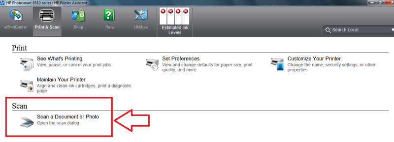

Step 1: Scan through HP Scan:
1. Click on the HP Printer Assistant software icon on your computer desktop
2. When the HP Printer Assistant opens select Scan a Document or Photo. HP Scan will now open.

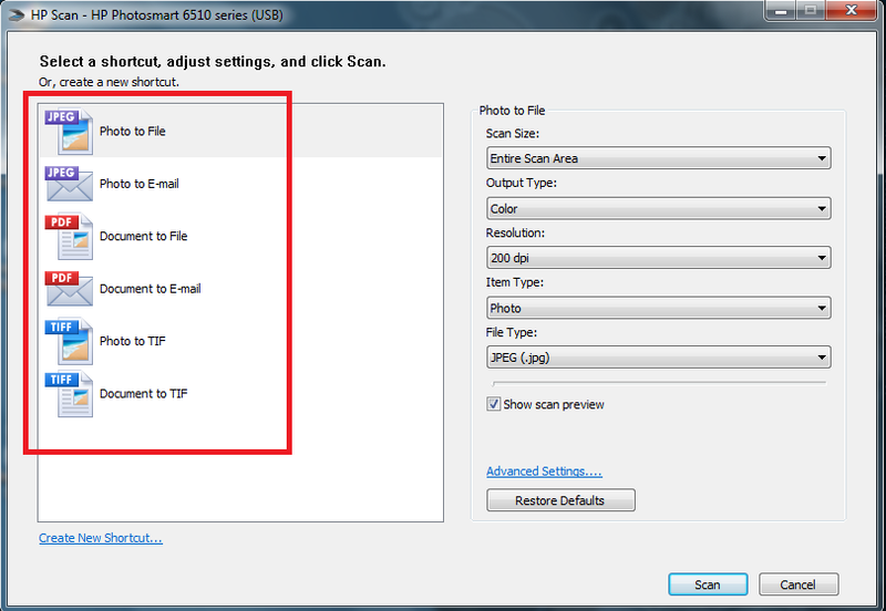

3. When HP Scan opens select the scan option you wish to test on the left hand side.

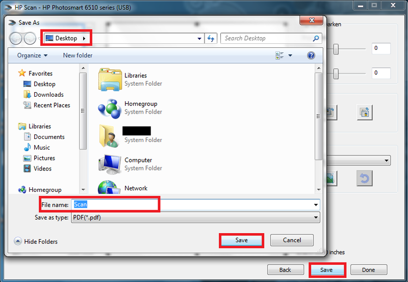

6. Once the scan is complete, click Save under the HP Scan software on your computer and you will be able to save the scan on your system

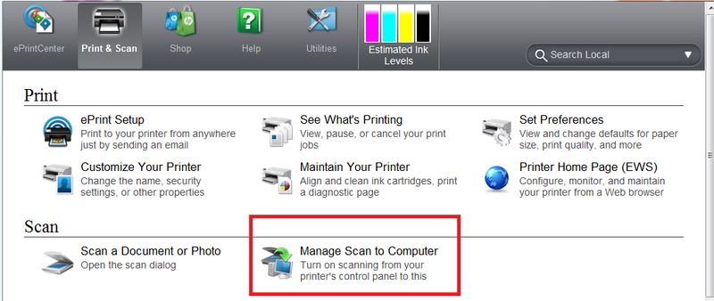

1. Click on the HP Printer Assistant icon again
2. Under the HP Printer Assistant click on Manage Scan to Computer
3. Under the Scan to Computer window, if the feature shows as Disabled, click Enable. Make sure the box is checked for 'Automatically start Scan to Computer when I log on to Windows'. Click Close once changes have been made.

The first four options are there but there is not a Scan option under them like in your picture. There is also not the top row of icons such as ink levels etc. I have also tried to find the hp printer assistant but i can't hewlett packard. Very frustrating
