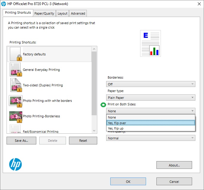

Now, if we can just get the printer to print in the same direction
for singe sided and duplex printing (both sides) when using
3 hole punched paper I'll be a much happier camper.
Thanks, the video worked.

For the print direction, think you may need to set the Duplex printing to be either "Flip Over or Flip up" (from the print driver)
Example:
Have a nice day!
