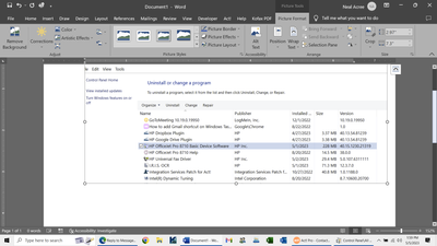

This is image of software installed on computed as listed in Programs & Features:
Version  40.15.1230.21319 ( only link I could find for Win10 64 bit OS.
Is there a better download and where is it found.
@ark210
The image shows the software installed in Programs and Features.
Yes, this is the full feature software.
No, there is not a "better" installation package.
