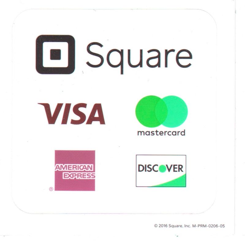

Thank you for your reply.  I have competely reset the printing system on my MacPro as per your directions.  I still have the problem.  The first image I've attached is a downloaded version of the physical card that I have scanned.  The second image I've attached is how the physical card looks after it has been scanned.  You can see how the colours have changed.  I've also tried this on a Macbook Pro and have the exact same problem.
While doing this I found out one more thing:  The image will scan properly if the destination is to a jpeg file.  The problem occurs when the destination is a pdf file.  I realized this while scanning these images.
Since this discussion board does not allow pdf attachments, I tried scanning to a jpeg file.  Amazingly the jpeg colours were correct!  When I scanned to a pdf the colours were wrong again.  I actually had to export the pdf (with the wrong colours) to a jpeg file (with the same wrong colours) in order to upload it here.  I hope that makes sense.  It is somewhat convoluted.
In summary this is a problem with exporting colour images to pdf format.
Unfortunately I do need pdf files for my work.  Also, I only chose this image because it has several colours that are changed when scanned to pdf.  This has nothing to do with Square, Visa, MasterCard, American Express or Discover.
Any idea?

After reviewing your post thoroughly, I see that you are able to scan the images using Jpeg however having issues scanning the file in PDF. Don't worry as I have a few suggestions which should help you resolve this issue.
Let's try to change the PPI settings: Color, grayscale, and black and white define the number of colors possible. You can adjust the scanner hardware resolution to up to 1200 ppi. The software can perform an enhanced resolution up to 19,200 ppi. You can set color and grayscale at 1 bit (black and white), or at 8 bit (256 levels of gray or color) to 24 bit (true color). The resolution and color guidelines table lists simple tips that you can follow to meet your scanning needs.
Let me know how it goes for further assistance.
