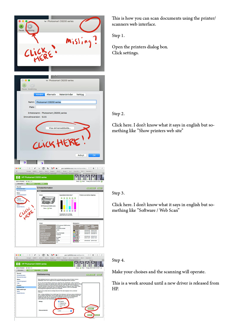

Have you tried to connect from your browser?
Type in the scanners IP address in Safari, something like 192.168.1.111
If the scanner have a web interface you can controll your scanner from that interface and do the scannings you need until new drivers from HP is released.

This is a way to find and use your scanner.

Oh my god, it works! Thank you, you're a hero.
After clicking "Scan" and seeing "Scan Done", I couldn't find the scanned file.
Instead, I clicked "Preview" again, and then dragged the preview image to the desktop. That works.
