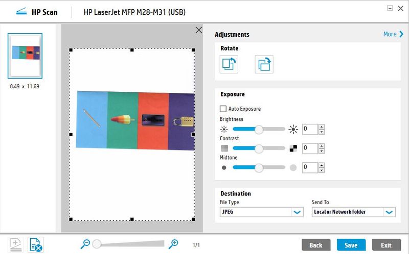

I just followed those steps, but that unfortunately hasn't worked. I'd previously tried removing the software, but this time I did it again as per your instructions and also removed the driver, but I've just reinstalled everything and the issue appears to be the same. The printer scans the image but then the software just sticks at this point-
That image above was with a leaflet taking up the whole scan area. I folded the leaflet up and scanned again, and it worked fine. Another image to show how it looks when it works-Capture.JPG

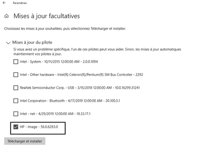

hello,
ihave the same problem since about 3 weeks on my windows 10, 64.
I did nothing to get this issue, excepting windows update, so it could come from an update of windows ?
i have just found the fix
go to windows update and select optionnal update
Hi David
Thanks for the recommendations. I just tried that and it unfortunately did not work for me though.
