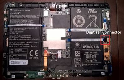

I have had a similar experience with my Omni 10 as well. I went so far as upgrading to Windows 10, and while it did work for a few hours, it stopped abruptly and despite many reboots, re-installs and just about everything else I could think of, I was unable to get it to work. Since my warranty had expired already, I decided to open it up and figure out the issue. I found that the loss of the touch screen function was caused by a poor contact on the digitizer connection. I noticed that when I would press it down firmly, the touch screen would work, and upon releasing it would not. So how to fix it? I tried at first with some foam tape (weather stripping) to keep the pressure on the connector, which worked for a few days until the tape became permanently  imprinted with the circuit relief... I went a step further and used some harder rubber from a gasket, cut into strips and piled on top until the correct thickness was achieved, then taped down with a strip of electrical tape. For good measure, I also added the foam weather stripping tape to each of the other connectors.
I realize this process will certainly void your HP warranty if your tablet is still covered, but in the case where it is not, it is better than throwing it away...

Just used your advice on this and (touch wood) the digitizer is working again!

Based on my experience, the fix that CrazyK used will deal with about 90% of the touch issues but the Omni has some other issues that only a simple reboot will fix.  So if you feel like this fix doesn't take care of it, just do a the reboot and I'll bet you'll see that you'll get ĉlose 99% satisfaction related to the touch screen issue.

Have personally found the issue with the touchscreen was hardware related as the touchscreen wouldnt work in the BIOS. I have had to sort out the problem with the driver previously, but have found that since a clean install of windows (as per one of my previous posts - how to reinstall using a Windows ISO on a USB stick) I havent been having driver issues on both Windows 8.1 and Windows 10, just the hardware problem (which took a good number of reboots before it worked, and was getting progressively worse). Touch wood, everything appears to be working since I have used the CrazyK fix.
