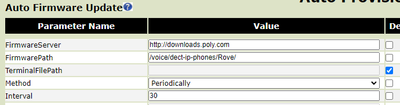

From this section and our more common VoIP section FAQ or the Read 1st section:
Now 10, 2023 QuestionHow can deploy a Rove Base Station or Register a Handset?
Resolution: Please check >here<
System Management > Auto Provisioning > Auto Firmware Update:
FirmwareServer
http://downloads.poly.com
FirmwarePath
/voice/dect-ip-phones/Rove/
Method
Periodically
Interval
30
then System Management > Auto Provisioning > Firmware Versions and Handset Images
BaseFWVersion 8010
BranchFWBranch 0002
Rove20FwVersion 8010
Rove20BranchVersion 0002
Rove30FwVersion 8010
RoveB30branchVersion 0002
Rove40FwVersion 8010
Rove40branchVersion 0002
RoveR8FwVersion 8010
RoveR8BranchVersion 0002
I suggest you contact our Support organization in your region if no other volunteers reply. Details are in my Signature.

Hi Steffen,
I downloaded the firmware file from here: https://support.hp.com/us-en/drivers/rove-base-station-series/2101728172
and I uploaded it to my Metaswitch SIP Provisioning server. I told the phone to upgrade to v8.0.10.0002 and that is how I got to the MD5 error upon the B2 base trying to apply the firmware.
I just tried your method, telling the phone to download directly from Poly and the phone upgraded successfully. I downgraded to v8.0.5.002 and then took the files from download.polycom.com and put them on my Metaswitch SIP provisioning server and now I am able to upgrade to v8.0.10.
It seems like the firmware files from  https://support.hp.com/us-en/drivers/rove-base-station-series/2101728172  may be bad.
