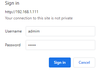

  • Connect to the Base Station using HTTP (not HTTPs) and use admin / admin as the default username and password
  • A new prompt may appear to ask to change the default password
  • Once changed please log back in with the new password

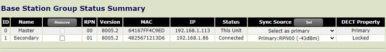

Base Station Groups
  • Select base station groups (only appears when you’ve enabled multi-cell) via DECT Wireless > Base Station Group
  • Set the primary base station and secondary base station.
    Note: The initial synchronization of a base station will take 1-2 minutes.
  • A DECT Base Station needs to "see" other Base Stations  (overlap) if a Handover between base stations is expected
  • The DECT chain will show the multi-cell relationship when complete
  • The base station group status summary will also show the connection status
    NOTE: Ensure the signal strength is no lower than -60 dBm
