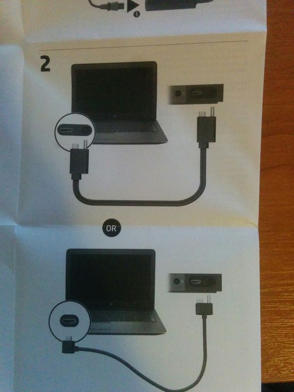

I bought a HP ZBook Thunderbolt 3 Dock and it works well but according to the documentation there are two cables available to connect it to a laptop, one with an additional power plug and without. I like to buy the one without, where can I find it? I have found the one with additional power plug: Z4P20AA

I have found the cable it belongs to the elite book dock. So when I search for parts belonging to: P5Q54AA http://partsurfer.hp.com/Search.aspx?searchText=P5Q54AA
The cable has number: 855117-001

The following link shows all accessories of the dock, only ONE cable, I think it is SPS-HP ZBook Thunderbolt 3 power cable A:
http://partsurfer.hp.com/Search.aspx?searchText=P5Q58AA

The second cable is actually comes with a different dock, which is
http://www8.hp.com/au/en/products/oas/product-detail.html?oid=9822180
and you can find part # in

The most importend thing is the amount of power it can transfer. The max is 100w and my laptop needed 90w. As a cabel I bought a 20Gb/s cabel, where even 40Gb/s is possible. For the specifications see below.
My laptop is a: HP Spectre x360 - 15-bl110nd. I spend sometime figuring out that only the second port of my laptop had thunderbolt capabilities. The other one is only a usb-c port. Currently I have connected two screens (full-hd), a network cabel and a headphone to the dock.
Hope it helps,
Regards
Simon
