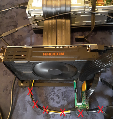

@Papatado1,
You mean the next picture -yes, it shows the PCIe extension power cable, which I explained you don't need and don't want:
Kind Regards,
NonSequitur777
The cable in the photo I was taling about looked to be an 8 pin cable that was attached at the top of the GPU. That looked to me like it might have had an extensions cable on it but It is very possible I was mistaken.
@Papatado1,
Yes, those are the GPU's PCIe power connections: some graphics cards need one 6-pin, others need a single 8-pin, and other cards, such as my RTX 3080 OC 12GB, requires two 8-pin PCIe power cables, etc. powered from the external, synced ATX power supply.
In other words, it depends on your particular graphics card's PCIe power requirements.
Kind Regards,
NonSequitur777
Yea that connection was confusing me a bit to be honest.  Thanks again!

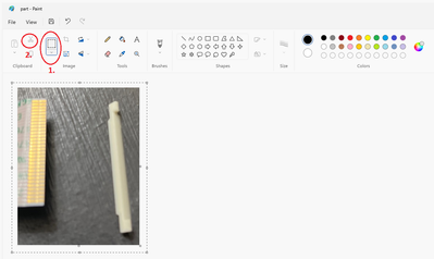

Here's how I generally do it:
Step 1.) Take pictures with your mobile
Step 2.) Email them to your email account or transfer them to a PC
Step 3.) Start Microsoft "Paint"
Step 4.) Open each emailed picture onto your screen
Step 5.) Take a 'screen shot' (keyboard key labelled as "PS" or "PRNT SCRN" or something like that)
Step 6.) Use the Paint program's "Paste" option
Step 7.) Use the Paint program's "Select" (red circle 1.) and "Rectangle" to mark the section you want to post (see the dotted line below), and then use the "Cut" (red circle 2.) function to transfer this 'cut' selection to your post by left-clicking your mouse in your post where you would like the screen-selection to go, and then do a right-click and use "Paste" -see example below:
Kind Regards,
NonSequitur777
