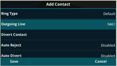

A new supported field for the Outgoing Line Parameter
<ol> Outgoing Line 0-Amount of lines per phone
0 is first line
Add an Outgoing Line to a contact’s directory information to specify the line to use for the contact. This

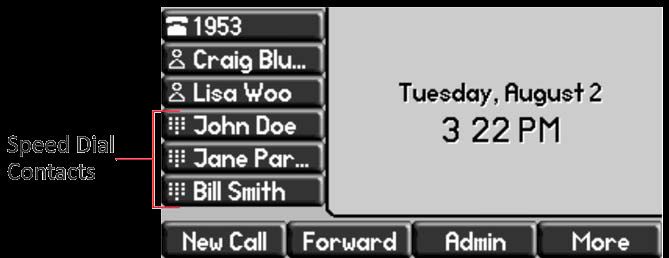

Using the Speed Dial / Favorite Field:
The <sd> field can be used for Speed Dials to directly Dial certain Numbers without having to browse the local directory.
NOTE
  • VVX 300, 310, 400, 410, 500, 600 Maximum of 500
  • VVX1500 and SoundPoint IP 450, 550, 560, 650, 670 Maximum of 9999 (Note that the maximum is limited by the phone's available memory.)
  • SPIP 321, 331, 335, and all SoundStation IP conference phones with a Maximum of 99
To dial this number you would simply dial the digit(s) that you specified in the <sd></sd> section and then press #
If you use the Lauren Gates as shown above you would dial 13# and the contact 555555556 would be dialed.
The Numerical Entry in the <sd></sd> field also defines the Position of the Speed Dial that is applied to the free line keys on a Phone.
The <sd></sd> is not mandatory and can be left out of the XML structure if you want to prevent for Speed Dials to be automatically populated on the free phone keys. You can still dial them from the phone directory.

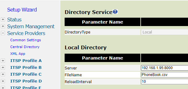

Central Phonebook
Poly Rove
  • Set Service Providers > Central Directory > DirectoryType to Local (Default)
  • Service Providers > Central Directory > Local Directory
Server URL to HTTP or TFTP Server
FileName Any .txt or .csv or .xml file
ReloadInterval Frequency of how often the file is pulled
HTTP server Logs (miniweb)
Connected clients: 1
[664] request path: Directory/PhoneBook.csv
[664] 231 bytes sent (231 KB/s)
[664] 297 bytes sent (297 KB/s)
[664] socket closed after responded for 1 requests
For more details check https://docs.poly.com/bundle/rove-ag-current/page/configure-a-local-central-directory.html Example Local Central Directory Files

Speed Dials
The phone can also store up to 99 Speed Dials. These can be added via User Settings > User Preferences > Speed Dials:
