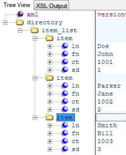

  • 00000000000-directory.xml => Speed Dial file

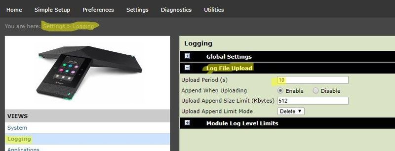

Capturing Logs via a USB Stick:
  1. Insert a Fat32 formatted stick with a 000000000000.cfg => Master Configuration File
  2. The Trio or Visual+ will recongize the stick and prompt (Trio only) the user to enter the Password (details => here <=).
  3. The user will be prompted to USB Provision the Trioimage
  4.  A USB Icon will indicate the a stick is inserted into the Trio
  5. Changing the Upload Period to a shorter duration will enable the Trio to upload the logs more frequently
  6. Once disconnected and inserted into a compatble PC the logs can be found
