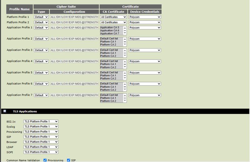

Using a CCX as an example, you find the SSL / TSL selection via the Web Interface Settings > Network > TLS > TLS Applications. This may depend on the Software version used.
