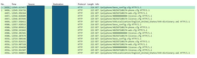

On boot the phone is correctly calling out to the HTTP hosted file location. However, during a Wire Shark of the communication between them, there are entries like these stating that the phone is not able to read any of the discovered config files...
If I rename the files to a standard .xml file I _can_ read them from a browser separately. Validating the directory they are being served up from is not restricted. I can also enable 'file browse' in IIS and I am able to view the directory within a browser and the files present.

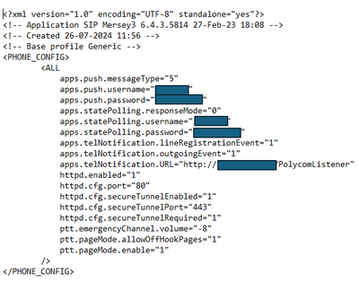

The config file content is as follows...
Ultimately the need is to enable the 'Applications' and 'PTT' functionality...

I was figuring since it was not HTTP/HTML content hosted on the IIS server - browsing to it from my or anyone else's workstation returns a 404 error on the .cfg file no matter what - was what was going on. Changing the file extension to .xml it would load fine on workstation browsers. However, seeing the phone cycle through some other .cfg files that were present in the directory return a 404 as well in the Wire Shark details is telling. Same behavior when changing the file to .xml for the phone to read.

The phone did call out for the files as seen below in the WireShark details. No 404 errors...

I found the following configs in the global.cfg for this model and enabled/set them as needed, but again, still the same result - in that they are not actually being enabled - via this provision method. The menu option is greyed out...
apps.push.messageType="5"
apps.push.username="[redacted]"
apps.push.password="[redacted]"
apps.statePolling.responseMode="0"
apps.statePolling.username="[redacted]"
apps.statePolling.password="[redacted]"
apps.telNotification.lineRegistrationEvent="1"
apps.telNotification.outgoingEvent="1"
apps.telNotification.URL="http://[redacted]/PolycomListener"
httpd.enabled="1"
httpd.cfg.port="80"
httpd.cfg.secureTunnelEnabled="1"
httpd.cfg.secureTunnelPort="443"
httpd.cfg.secureTunnelRequired="1"
ptt.emergencyChannel.volume="-8"
ptt.pageMode.allowOffHookPages="1"
ptt.pageMode.enable="1"
