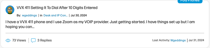

I have a VVX 411 phone and I use Zoom as my VOIP provider.  Just getting started.   I have things set up but I am hoping you can help with an issue.  I want the phone to dial automatically after I enter 10 digits (123-456-7890 for example) and a second or two passes.   The Owners Manual says that it is possible to set it to do this but that it has to be done by your system administrator.  Since that is me, I have no idea how to do that.   I cannot find any instructions on setting "system administrator" things.
I thought maybe it was something through Zoom just like I can set the programmable keys through Zoom but they claim it is a Poly com issue.
How do I set it to dial after 10 digits?  Where can I find a "system administrator" menu?
Thank you.

Hello @wgeddings
your post is here:
The latest posts can always be found >here<
