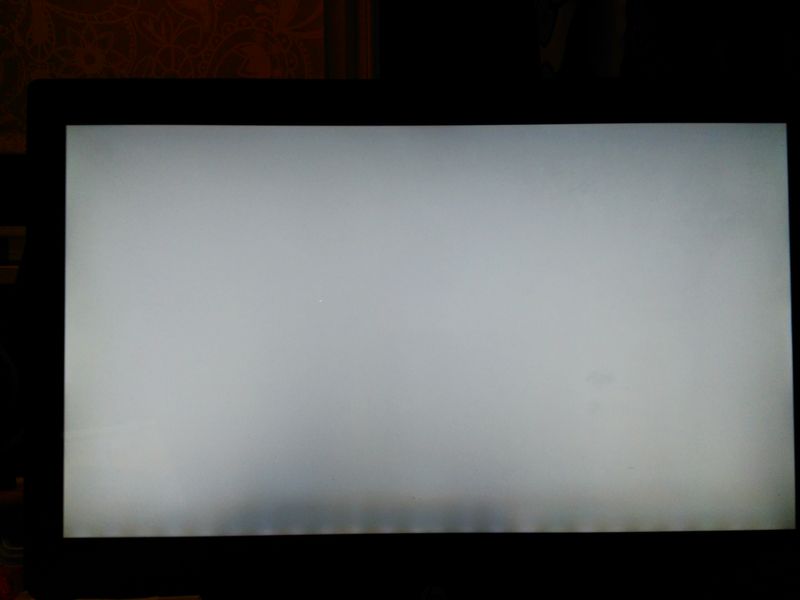

I have a HP Z1 workstation (purchased in juni 2012). This has a 27" display.
Since a couple of days the left side of the display is noticeably darker than the right side.
Is there a way to repair this?

Hi migsn
Not following what you did.
The objective is to either: (1) connect a different monitor to the Z1, or (2) connect the monitor now connected to the Z1 to a different PC. Either monitor test can be done.
1. Same result using a different monitor suggests a Z1 problem (driver or hardware). The screen image problem occurs on one or more monitors.
2. Same result on a different PC suggests a monitor problem. The screen image problem follows the monitor to a different PC.
Grzy

Hi migsn
Thanks for the additional info.
I tried to locate HP Z71 with no hits in HP's product database.
Assumed it was a desktop.
No monitor image problems on an external monitor means you have a problem isolated to the All-In-One.
Try updating the graphics driver.
No luck with this means the monitor backlight is failing or some other hardware problem.
Contact HP if in warranty or have a local tech diagnose the cause.

I'm having the same problem with my HP Z1 g2, except it's the right side of the screen that is dim. Also, my unit is emitting a high pitch noise as well. I connected the display port on the z1 to a second monitor (to check it, as recommended) and the image on the second monitor is fine (no dimness). Also, when if I turn off the z1 display (just keep the image on second monitor) the high pitch noise stops as well. So it appears to be bad display.
migsn, did you ever get your problem fixed? If so, what did you do?
My inclination is to replace the display. But I want to be be sure that will fix it. Thanks for any feedback!
