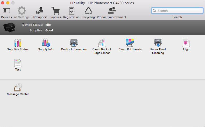

I am aware of the 2.4 network being the only one the printer will connect to, and the printer shows that network in the list of discovered networks. But it won't connect when i try the "push button" on the printer and modem. When i have it connected with the USB it will print. The "wifi" light is a steady blue.
The wireless setup is not in my utility box. When i try the steps you sent without a cable connected, the utility or the MAC printer/scanner setup does not find the printer. The wireless worked in the past using an older iMac. Thx againScreen Shot 2019-03-11 at 2.53.38 PM.pngScan 1.pngScan 2.pngScan.png
