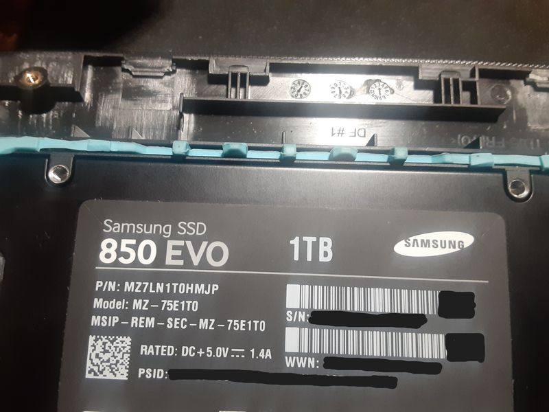

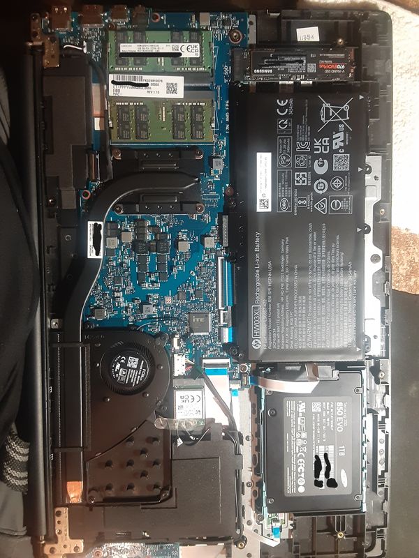

05-27-2022 12:37 AM - edited 07-15-2022 01:34 PM
Ok I'm back from the dead. It works.
I now have both my new NVMe 970 EVO Plus 1TB and my old 850 EVO 1TB 2.5 in SATA, as well as new DDR4 3200 - 32 GB Samsung 2Rx8 installed and just booted up with a clean install of windows 11 which I am typing on now.
Here's the breakdown, while I wait for drivers to install:
I tested each cable for pinouts with a meter against the SATA spec for the drive side. I wanted some assurance there was some year over year consistency before maybe I actually stuck a drive in. I also was not about to try to use probes on the ZIF on a live laptop. What I learned I think might help a few others.
The list of known good cables (by me) for HP cp100, cp000, cn000:
| Picked | Cable model | Laptop series | eBay item I ordered | |
| * | L23889-001 | 15-cs, 15-cw, 15t-cs, 15z-cs, etc... | https://www.ebay.com/itm/284251101364 | near same lenght and folds work as is |
| L22534-001 | 17-by, 17-ca, 17q-cr, 17z-ca, 17t-by, etc... | https://www.ebay.com/itm/224994774300 | longer than neccessary, would still work | |
| M75893-001 | 17-cp, 17-cn, 17z-cp, etc... |
The 17-j / 15-j series will probably also work fine, but are missing the 3.3v NC pin, which has no connection to the cable or motherboard, but may be used to trick certain odd drives. No 2.5 inch drives that I know of have a connection to any 3.3v pin. It's easy to see by looking at the drive and the traces and how those pins arnt even connected to the boards. 2.5 inch boards are just void of 12v and 3.3v. MSATA that uses only 3.3v, and 2.5 inch SATA uses only 5v.
I chose the cm-15 cable because it was nearly the same length and the fold was already in the right place.
I used an old 17-j/15-j series drive blue caddy, the thin blue rubber kind, trimmed to mechanically fit the same. I Attempted using the 17-by and 15-cm caddies, but there were various issues. The BY was too fat, the rails weren't skinny enough, and the cm was just one side. The DV style caddies are just thin enough to fit. Is a very nice fit around the edges.
If you watch the HP 17 cn/cp000 disassembly video, and some of the others, you can see the drive itself is supposed to be nearly flush with its mount hole sides, and the black nubs stick up a bit, and there is no material between the drive and the cable. Its important to consider so that the case comes back together correctly and the cable have no real pressure on it from the case.
Here is the BIOS test screen showing both drives,:
Here is the 17 cp100 before the Windows 11 re-install, with all the new parts:
Here's the disk manager with both drives after the install:
