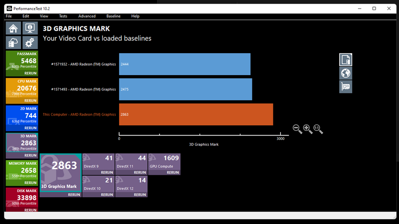

05-27-2022 01:12 PM - edited 05-30-2022 08:15 PM
I've now had a chance to test the new setup, the one in my answer last night.
see: https://h30434.www3.hp.com/t5/Notebook-Hardware-and-Upgrade-Questions/HP-17-cp-17-cn-and-470-g8-2nd-...
To be clear as I didn't really explain completely before, I ordered a custom 17z-cp100, the model which has the latest Ryzen U series Barcelo processor, which are basically the new budget U series, based on Zen 3 instead of the Zen 2 in the cp000. Thats why I finally pulled the trigger and bought one. I ordered with base drive and memory, but the top 5825u. I noticed the Wifi options kept changing, but when I ordered mine, it was left at the default which was the MT. In the end I ended up receiving the Realtek version of the AX+Bluetooth, which is fine, and I probably lucked out. I have an extra AX210 on hand, but I chose to leave the Realtek in when I did the upgrades last night.
I may come back and edit and fill in the model numbers of what i received for everything later. The default memory was Samsung 1Rx16 and the drive was dram-less Samsung NVMe. In the test they worked just fine, and with the exception of the drive test, the numbers were very close to my upgraded versions. The new parts are Samsung 970 EVO Plus 1TB and 32GB Samsung 2Rx8. I say all this so the tests below make sense for context.
So, here are the PassMark numbers:
The previous two are my tests from last night before upgrades on the stock OBE Win 11 (out of the box stock windows 11), run with HP default power profile, and stock Balanced profile, itself set to balanced. The current test today is clean Win 11 with the new parts described above, on stock Win 11 Balanced power profile, itself set to high. None of these tests were using APC TDP changer utility, this is stock TDP. I tried a few attempts, but it made it worse by a lot. I think these retuned xx25 processors are riding their own max temp with some new magic and I wouldn't bother. The CP/CNs are a single fan single pipe setup, and I'm getting numbers near-ish of the ProBook 14s, so I'm not going to bother. The juice is very good, and I'm not going to squeeze anymore.
Edit 5/30/2022:
I'd like to amend what I said before about the TDP. After finally checking, this model is already set for sustained 25W by HP. I thought maybe it was some kind of boost during the test, but its already tuned 25W automatically.
Today I tried HWMonitor, and kept a load on it using the Pass Mark home screen, and with a 1080p YouTube music video playing behind it, and it sat at 25w dead on for minutes and stayed maybe 77c the whole time. The site says 15W so maybe it means the normal stated marketing TDP for the Ryzen U series. But it will for sure automatically go 25w under sustained load. On the cp100 at least there is no bios option to turn on or off, so it's just this way all the time. The Cooler looks like it can take it just fine. I'd also like to point out that this was using Windows 11 clean install default Balance power profile, left itself at balance. So... this laptop is the real deal.
That one above shows 25w on package balancing GPU 3D render, 1080p video, and CPU.
This one shows CPU load at 25w, because I realized I hadn't seen the CPU only, yet so I went to check. And yep that works too. Max temp was 81.1. I might try prime later, which is only CPU. This one is mixed memory and CPU. The 7z settings were 8 Core and 24GB used for compression over 10GB of mixed data.
Second test with all 16 threads was doing about 32MB/s. 256MB dictionary size, 23GB memory used for compression.
The rest below was my original post from the 27th.
-- End edit --
1) HP OBE Win 11 stock, with stock parts, with stock Balanced profile, which I switched to, to test
2) HP OBE Win 11 stock, with stock parts, with stock HP power profile, that it originally started up with
3) Clean Win 11 stock, with new parts, with stock Balanced profile set to high
Link to the last baseline, my current setup, is here:
PassMark Software - Display Baseline ID# 1572341
I'd argue that this is probably the best performance, with or without my upgrades, of any budget to mid model out there by anyone at the moment, esp. if you want a 17 inch where pickings are slim, very cleverly disguised as the lowest one they offer. Good job HP.
