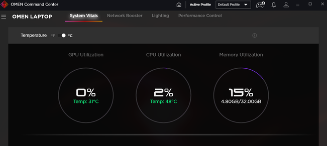

@GuillianJ
Please check your vent (in and out) areas. The following image shows my machine
I'm reading emails right now and we are in Winter but my room has a heater.
Regards
BH
