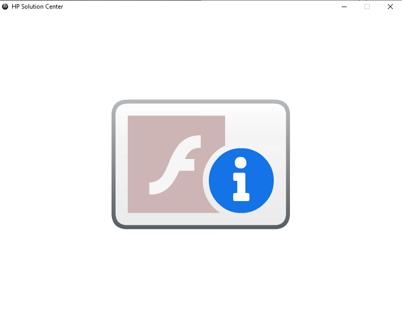

Officejet J4580
After the Flash Player does not work I can't open the HP Solution Center anymore.
I used the Solution Center to scan my documents to PDF file.
I heard from a app called HP Scan but i don't now how to install it.
I installed HP Smart from the Windows Strore but the App didn't find my printer. I think my printer is to old.
Can someone help me to solve this problem.
Hope that HP finds a fix for this problem and bring an Update for older Printer Softwares.

Hi,
Flash Player is retired and no longer working, the HP Solution center software is based on Flash:
https://www.adobe.com/products/flashplayer/end-of-life.html
You may install HP Scan Extended, then open the HP Scan Extended from the Programs menu and you should be able to scan:
https://ftp.hp.com/pub/scanners/HPScanExt/HPScanExt.msi
Shlomi
