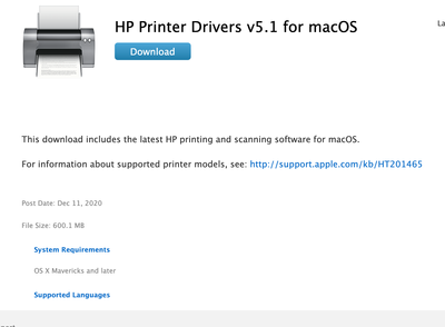

Is this the driver you installed?
So the driver you are referring to on Apple's site is: HP Printer Drivers v5.1 for MAC OS from Dec 11, 2020?
This is to work with HP Deskjet 3050A for print and scan?
