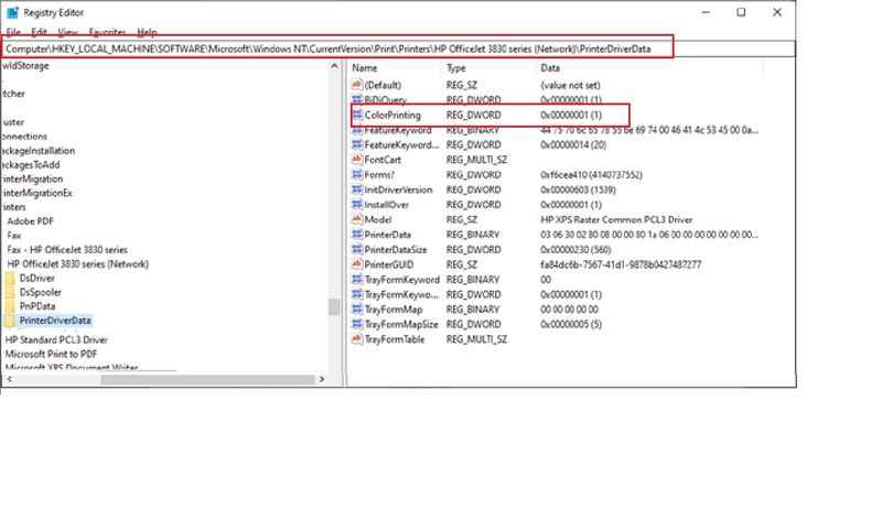

Thanks! Your registry solution worked perfectly. Not being a regular Regedit user, I had to fumble around a bit, but I have attached a picture of my registry when the solution worked.
