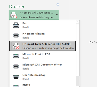

Hi guys,

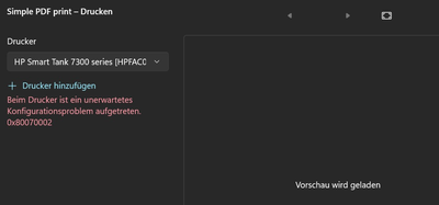

I connected my printer in the network and my devices see the printer. If I want to print anything (word file, PDF, etc.) I get the following error - see screenshot.
I have already reset the printer to factory settings and set everything up again, but unfortunately the error is still there. Any further advices?
PS: when i press the info button on the printer, it prints the printer's info page.
Thanks and best regards
Paul

Error code 0x80070002 on an HP Smart Tank 7305 All-in-One printer typically indicates a problem with Windows Update, file system issues, or missing files. This error often prevents updates, installations, or other software-related tasks from completing.
As you are using a Windows Pc, please try the steps shared below.
1. Clean the Windows Update Cache:
  • Method:
Open Command Prompt as administrator (search for "cmd" in the Start menu and run as administrator). Type the following commands one by one:
  • net stop wuauserv
  • net stop cryptSvc
  • net stop bits
  • net stop etrsvc
  • rd /s /q %systemroot%\SoftwareDistribution
  • reg delete "HKEY_LOCAL_MACHINE\SOFTWARE\Policies\Microsoft\Windows\WindowsUpdate" /v DisableWUForProd /f (if this registry key exists)
  • net start wuauserv
  • net start bits
  • net start cryptSvc
  • net start etrsvc
2. Check Printer Connection and Date/Time:
  • Method: Verify that the printer is properly connected to the computer and that the computer's date and time are correct.
3. Run System File Checker:
  • Method: Open Command Prompt as an administrator and type sfc /scannow.
  • Explanation: This tool scans for and repairs corrupted system files.
