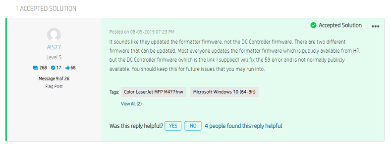

I have seen this discussion before and one user said-
"It sounds like they updated the formatter firmware, not the DC Controller firmware. There are two different firmware that can be updated. Most everyone updates the formatter firmware which is publicly available from HP, but the DC Controller firmware (which is the link I supplied) will fix the 59 error and is not normally publicly available. You should keep this for future issues that you may run into"
There is no link to any download when the user said there was a link. I will need a link to the download for the DC Controller firmware to solve this problem.

Here is what I see
I don't see a link at all even where he said "which is the link I supplied". Could you post the link here?
Seek and ye shall find.  Keep scrolling to next post.
https://www.dropbox.com/sh/liy40fjbmbfqhmj/AAAHQOsA-2Ap-upz-oG1nA_Fa?dl=0
