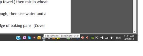

 Dear All
I have just purchased a HP Advantage Deskjet 3777 printer, which i want to use in my house for multiple "gadgets" , therefor i have chosen to use it wirelessly and all "gadgets" seems to print without any problems but for my notebook ,here comes the problem then .
I can't print any kind of microsoft office 2010 document unless i convert it into PDF or any other format.
If i open a word.doc and want to print ,then i click " file --> print " , then it shows the printer to be ready (first pic), then i click "print" and nothing happens only showing "0  document pending" (second pic) , then i try with any other format , in this case PDF and it print , no problen as you can see in pic three and four .

Thank you for your effort in trying to solve my problem , but
:Wink:
It was as i have mentioned before, NOT a printer/HW issue , it was "simply" a  Windows issue.
I changed the settings in my temp folders to " full Control" for all the shown users
This guideline are for Windows 8/8.1
  1. Go to Start and type:  "C:\Windows\" Copy and paste this without exclamation marks.
  2. A pop up window will appear , locate "Temp" folder in pop up and right click and choose properties  then "--> securty --> edit , then tick in appropriate users tickbox "full control".
the second "Temp folder" are located :
  1. Go to Start and type:" %USERPROFILE%\AppData\Local\" Copy and paste this without exclamation marks
Restart to make changes take effect.
