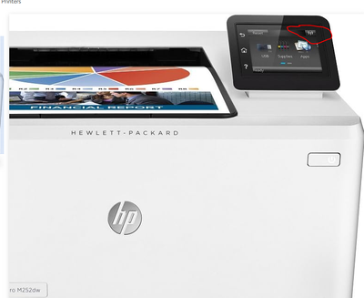

How do I get the IP address,

Either print the configuration page from the reports menu or touch the network icon in the upper right of the control panel. You can also download the user manual from support.hp.com that will provide details on navigating menus on your printer.
