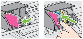

Step 3: Remove the ink cartridges, clean it and re-install the ink.
  • Open the ink cartridge access door.
    • The carriage moves to the left side of the access area.
  • Wait until the carriage is idle and silent before proceeding.
  • Push in on the front of one of the ink cartridges to release it, and then pull the ink cartridge toward you to remove it.
  • Remove all the ink cartridges.
  • Clean the ink cartridges.
    • Gather the following materials: A clean, lint-free cloth, A clean, dry cotton swab, Distilled or bottled water.
    • Lightly dampen a clean, lint-free cloth with bottled or distilled water
  • Gently wipe the copper-colored contact on the ink cartridges.
  • Wipe the contact with a dry, lint-free cloth
  • Examine the vent area located on top of the ink cartridge, next to the HP logo.
  • If any of the ink cartridges have clogged vents, use a pin to clean the vents.
              example of a clogged vent
                 example of a clean vent
  • Carefully reinsert one of the ink cartridges into its slot, and then push the ink cartridge forward until it clicks into place.
  • Check if the error goes off. Try to print/copy if there is no error.
  • if the issue persists, proceed to the next step
